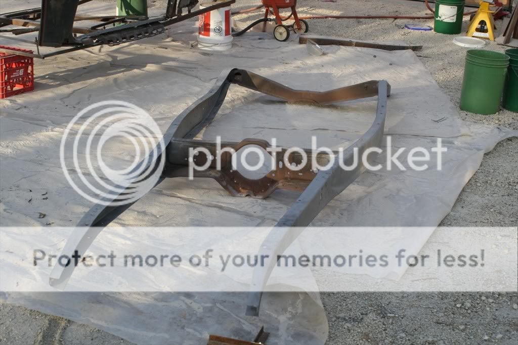

« on: November 05, 2012, 08:01:14 AM »
One of the all time favorites. With a lot of quarterbacking from my friend Beppie, I'm putting together a late 60's early 70's vibed coupe.
I started with this heap of parts, some gennie some repop.
A roached out coupe body, minus most of it's wood and broken away at the B pillars.
And a gennie frame.
Get the stance right, followed by fit & finish.

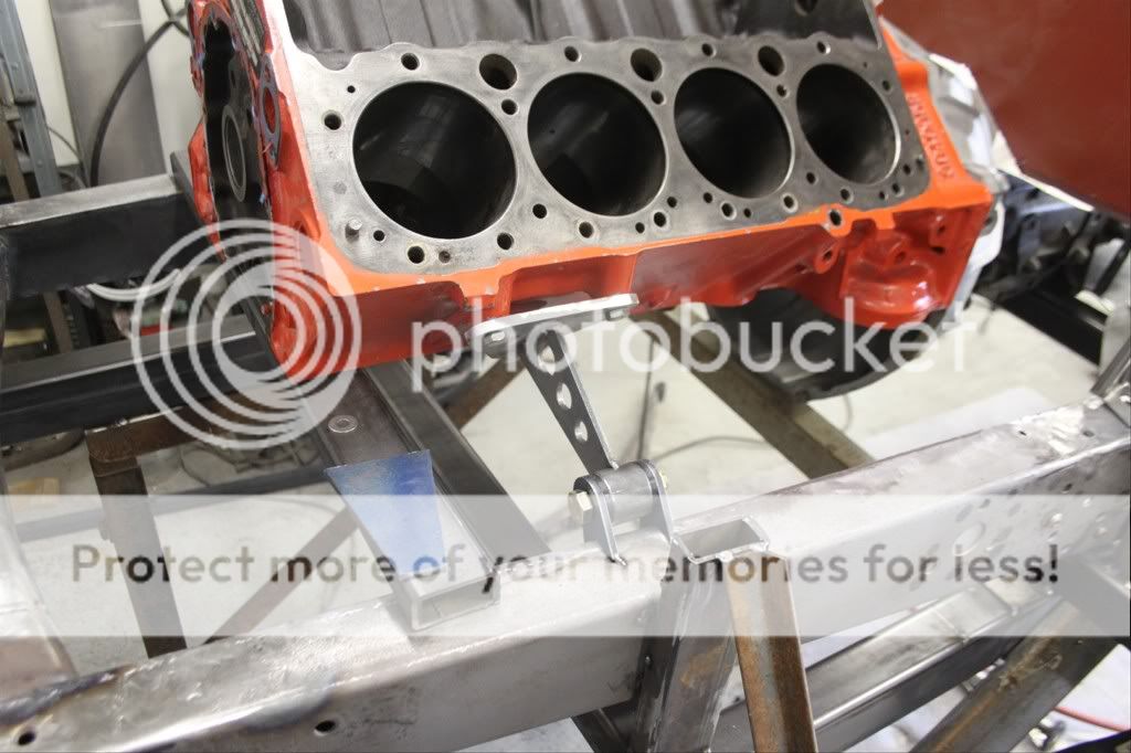

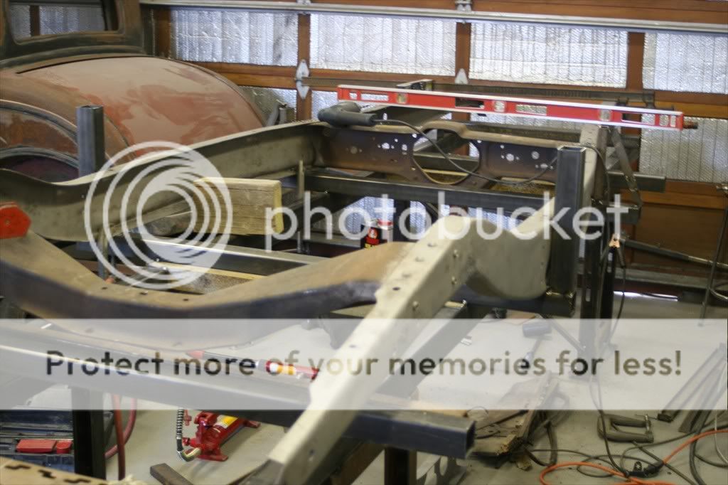

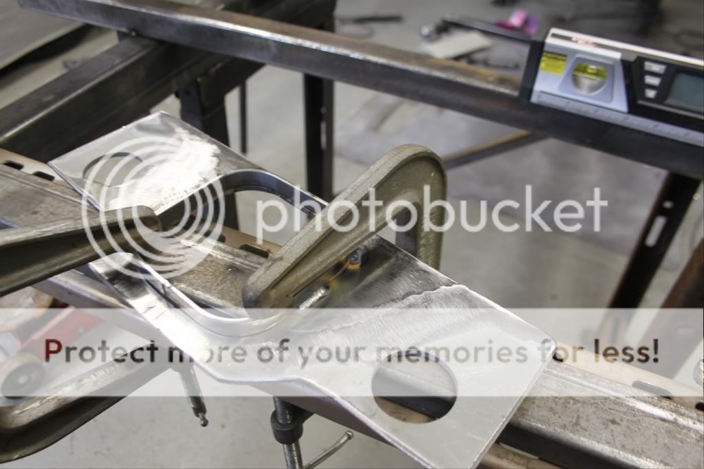

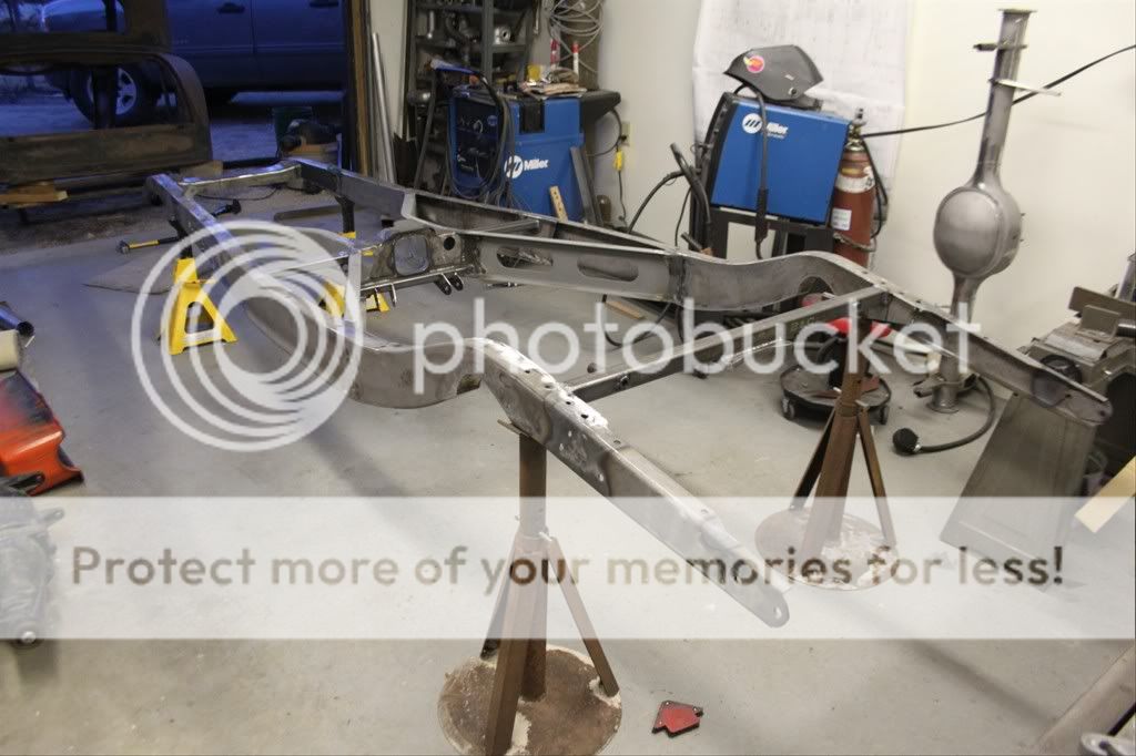

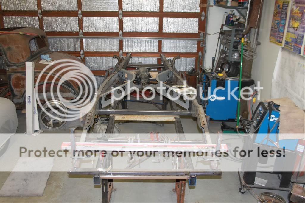

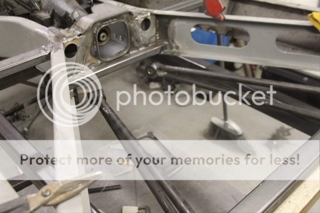

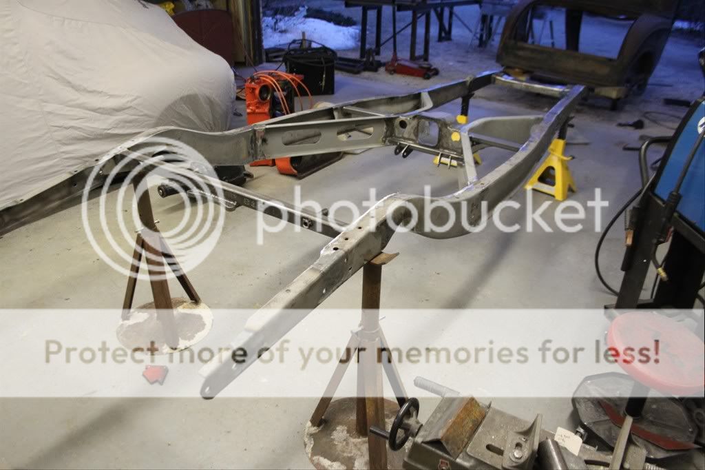

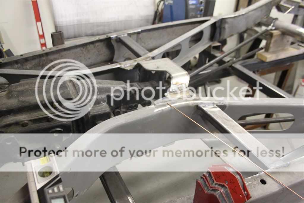

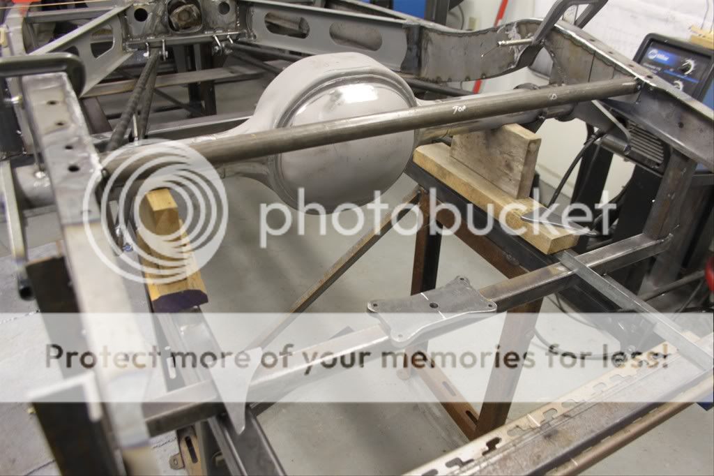

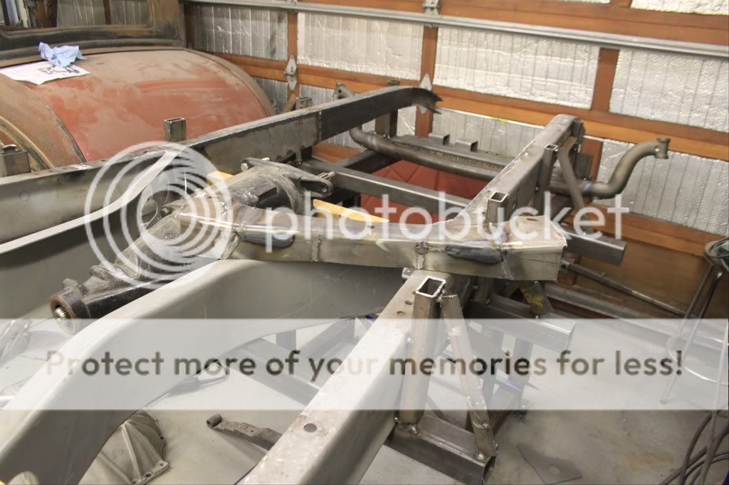

O.K. lets start with the frame build up.
Started with sandblasting.
Then tacked everything into my homemade frame table.
Added a Chassis Eng. X
Flipped the kits center mount & notched it for a T-10 4 speed.
Modified the rear plate of the kit.
Installed the rear plate and tied it into the ladder bar mounts.
Flattened a P&J front x member.
Installed a 57 Ford 9".
Made some race car inspired mounts.
Fabbed up my own rear crossmember for the Posies transverse leaf.
And there you have it, a basic Deuce Hot Rod Frame.

Here is the finished frame ready for the body.
